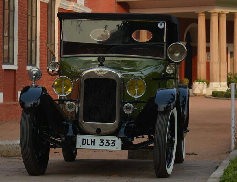

I only have one correct Lucas headlamp for the car so I have a pair of Marshals fitted, apparently off a Bugatti that was scrapped in the 40s or 50s! They work very well.
- 20190105_025748.jpg (316.57 KiB) Viewed 8026 times
