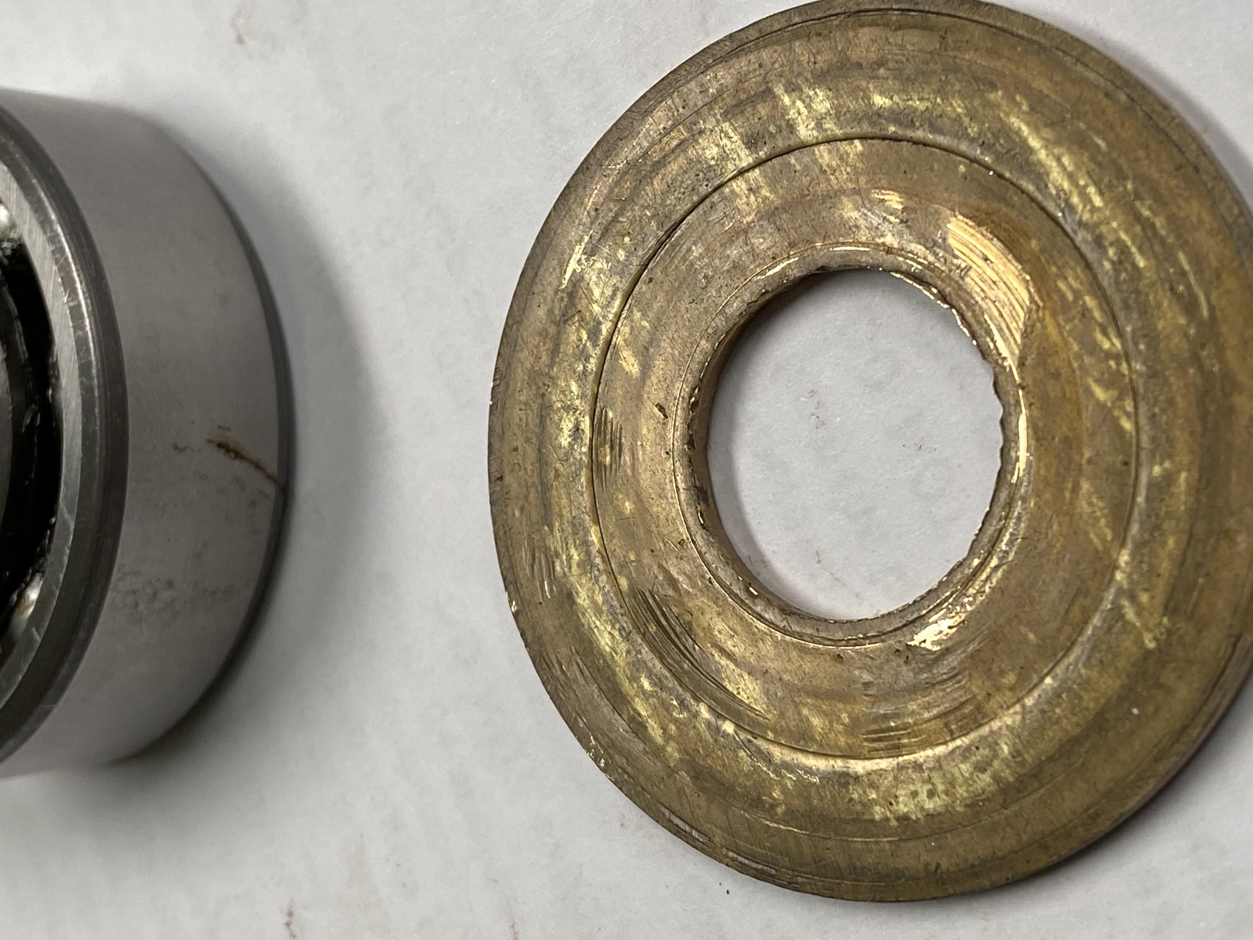

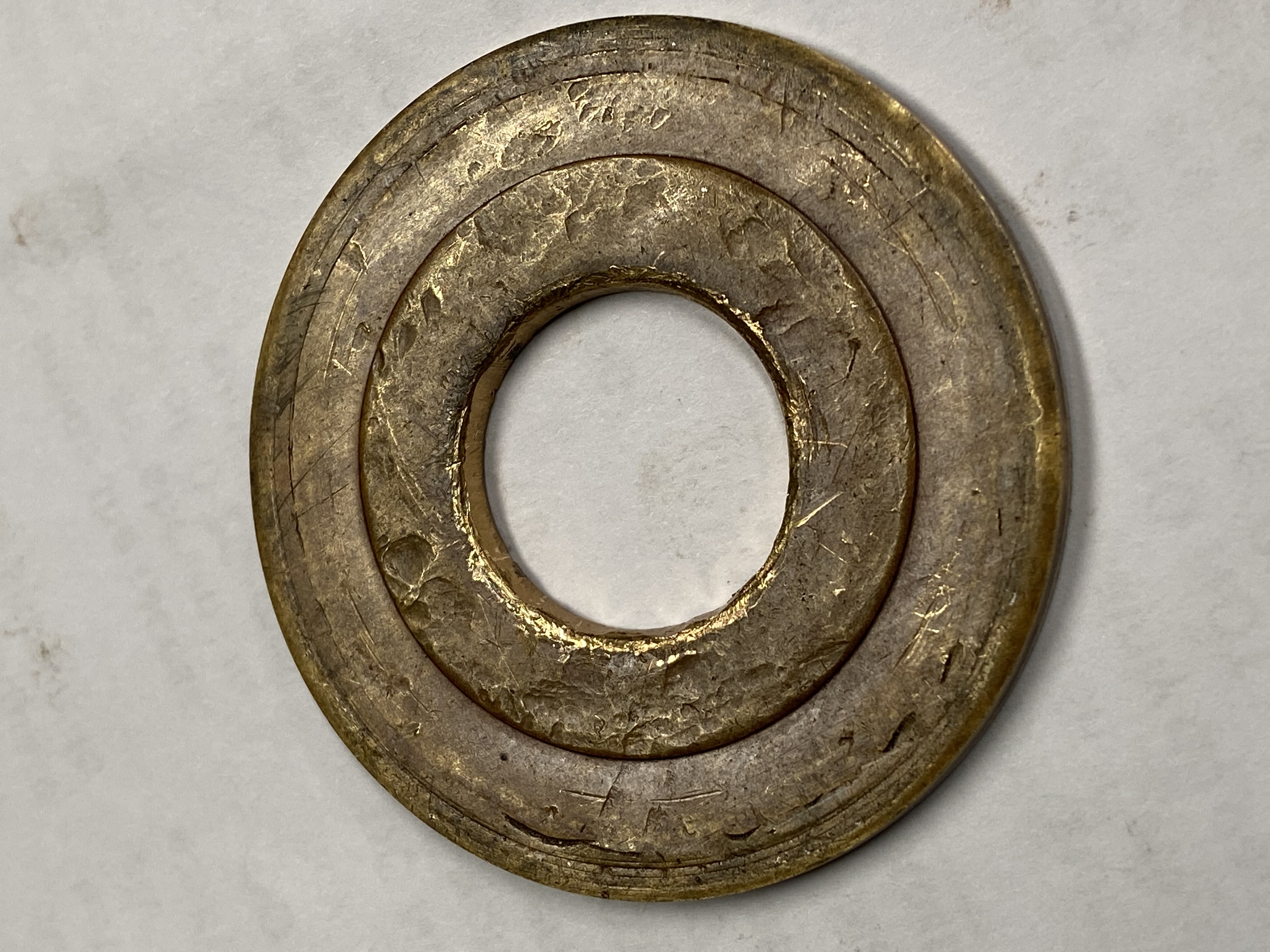

The clutch on my 12/4 short stroke engine has had problems with not always fully disengaging since I acquired the car almost four years ago. On dismantling it, it is apparent that the clutch bearing cover plate (AK25, see below) has rubbed against the bearing (AK24) which I assume has contributed to the clutch problem by causing drag on the input shaft to the gearbox.
It looks like the cover plate has had a hard time over the past 94 years.
I have pressed the cover plate back into the correct shape so that it now does not rub against the inner race of the bearing.

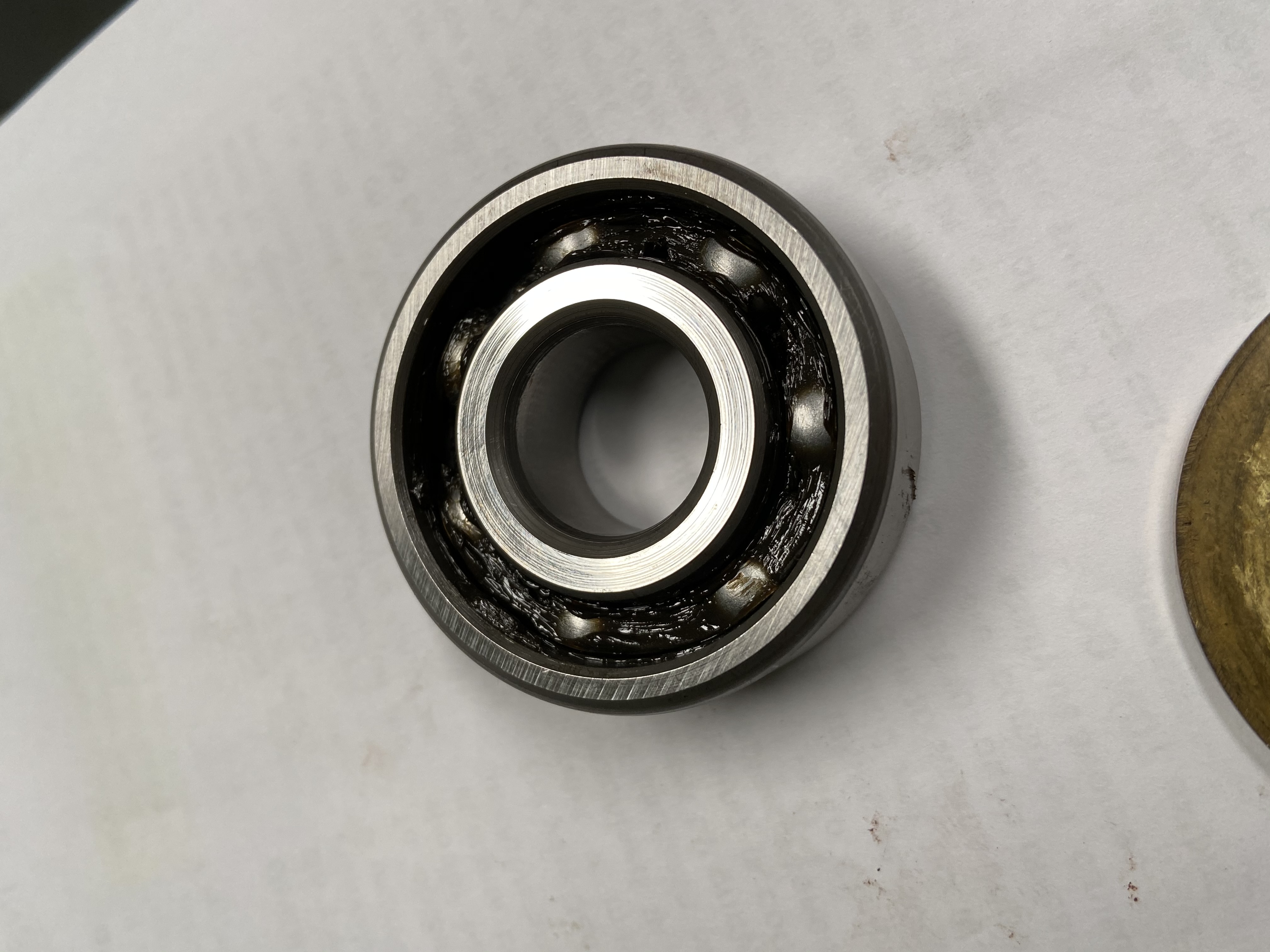

I've also bought a replacement clutch bearing with rubber seals on both sides - thinking that these could "only help" by retaining the grease and keeping any foreign material out of the bearing. However, I'm now wondering whether to remove one or both of the seals due to the friction they cause which appears to be similar to that due to the rubbing of the cover plate before I removed it.

The sealed for life bearings can be a good idea, but remember these are sealed for the life of the grease, not for the life of the bearing. Personally I would prise out the seal on one side, so that grease cannot escape into the clutch but the bearing can still receive fresh lubricant in the normal way. It's a matter of personal preference.

OK Neil, I misunderstood which bearing you were referring to. I don't have the 12/4 parts list so was making a guess. You are quite right, any drag on the clutch shaft spigot bearing in the flywheel will cause the problem.

If the spline on the first motion shaft is " Wavy" and there is corresponding wear in the female centre,together with the dished plate,it will be sticking in one place.
Keep your eye out for a replacement gearbox,rebuilding the one you have with worn gears and the input shaft would be a waste of time.
In the short term,get a good clutch centre plate AK 11 that is not worn on the spline.
The flywheel bearing,AK 24.I would leave the seals on if it don't foul the plate AK25,other than support the end of the first motion shaft,they don't rotate much,early cars used bronze bushes.
