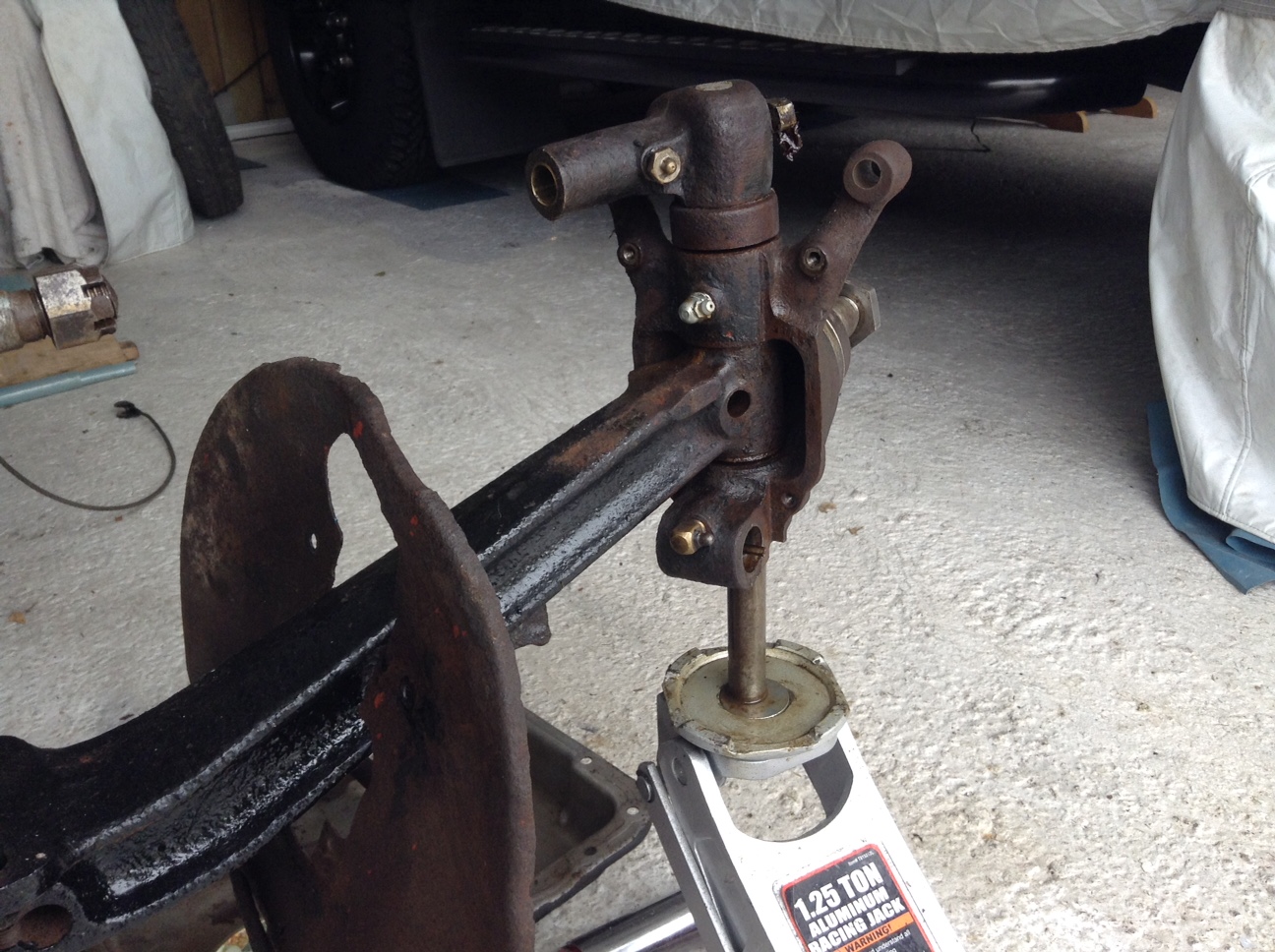

I am following in your footsteps and have got to this stage, see pic.Austin-App73-77 wrote: Mon Mar 06, 2017 7:09 pm King pins removed now so anyone wishing to know how - I may be able offer some advise.
I have also ordered the memory stick from our VAR spares.
Next stage heat and a good whack?

I was lucky as I had my axle removed from the chassis so I was able to drift the kingpins out with a brass punch and big hammer with the axle upside down on the bench.
I was more concerned that I was not going to do any damage by drifting them in the wrong direction - or if there was anything I had missed still holding the kingpin into the axle.
I have mine all back together now.
It looks like you are on the right path from your picture.
If you would like to talk on the phone you will find my number as Media-Moderator in the club magazine. If you are local to me (Worcestershire/ Gloucestershire border) I would be happy to help.
Rob.
Rob.

But I have now replaced the Jack with wood topped with steel.
Fingers crossed.
