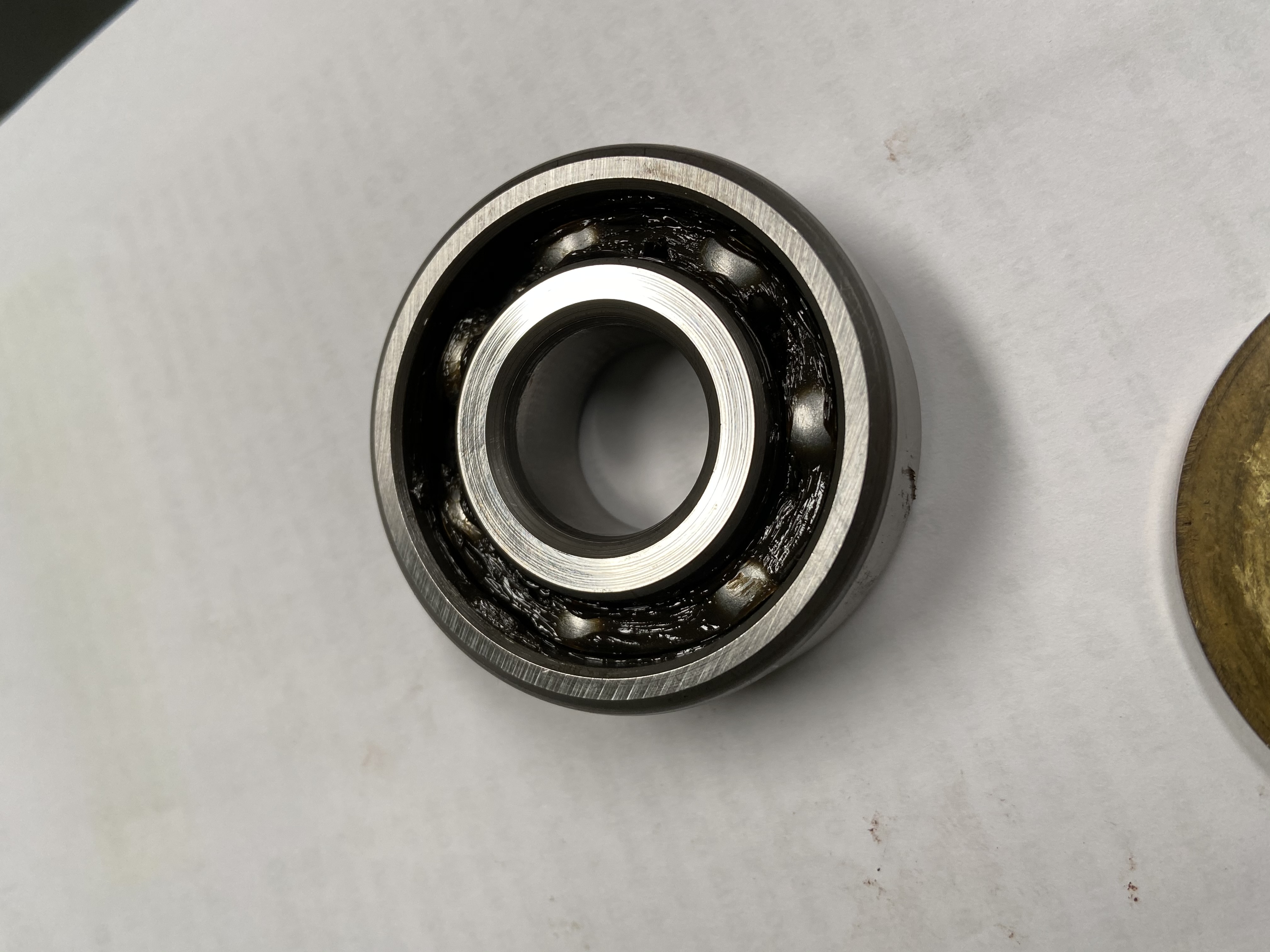

The clutch on my 12/4 short stroke engine has had problems with not always fully disengaging since I acquired the car almost four years ago. On dismantling it, it is apparent that the clutch bearing cover plate (AK25, see below) has rubbed against the bearing (AK24) which I assume has contributed to the clutch problem by causing drag on the input shaft to the gearbox.
It looks like the cover plate has had a hard time over the past 94 years.
I have pressed the cover plate back into the correct shape so that it now does not rub against the inner race of the bearing.
I've also bought a replacement clutch bearing with rubber seals on both sides - thinking that these could "only help" by retaining the grease and keeping any foreign material out of the bearing. However, I'm now wondering whether to remove one or both of the seals due to the friction they cause which appears to be similar to that due to the rubbing of the cover plate before I removed it.
So my questions are:
1) Is the friction due to the seals likely to reduce appreciably with the (little) "use" that the bearing will experience ?
2) What do you recommend with respect to removing the seals and why ?
Thanks in advance,
Neil

On the bearing front, it's the "clutch" bearing (AK24) in the flywheel that I was referring to, hence the outer race is pressed into the flywheel, not a fixed casing, so the drag was/is against engine rotation rather than something stationary. I like the idea of having an active means to slow the input and lay shafts rapidly when changing up - maybe a future project to squeeze in some sort of electromagnetic brake?

The flywheel bearing,AK 24.I would leave the seals on if it don't foul the plate AK25,other than support the end of the first motion shaft,they don't rotate much,early cars used bronze bushes.
