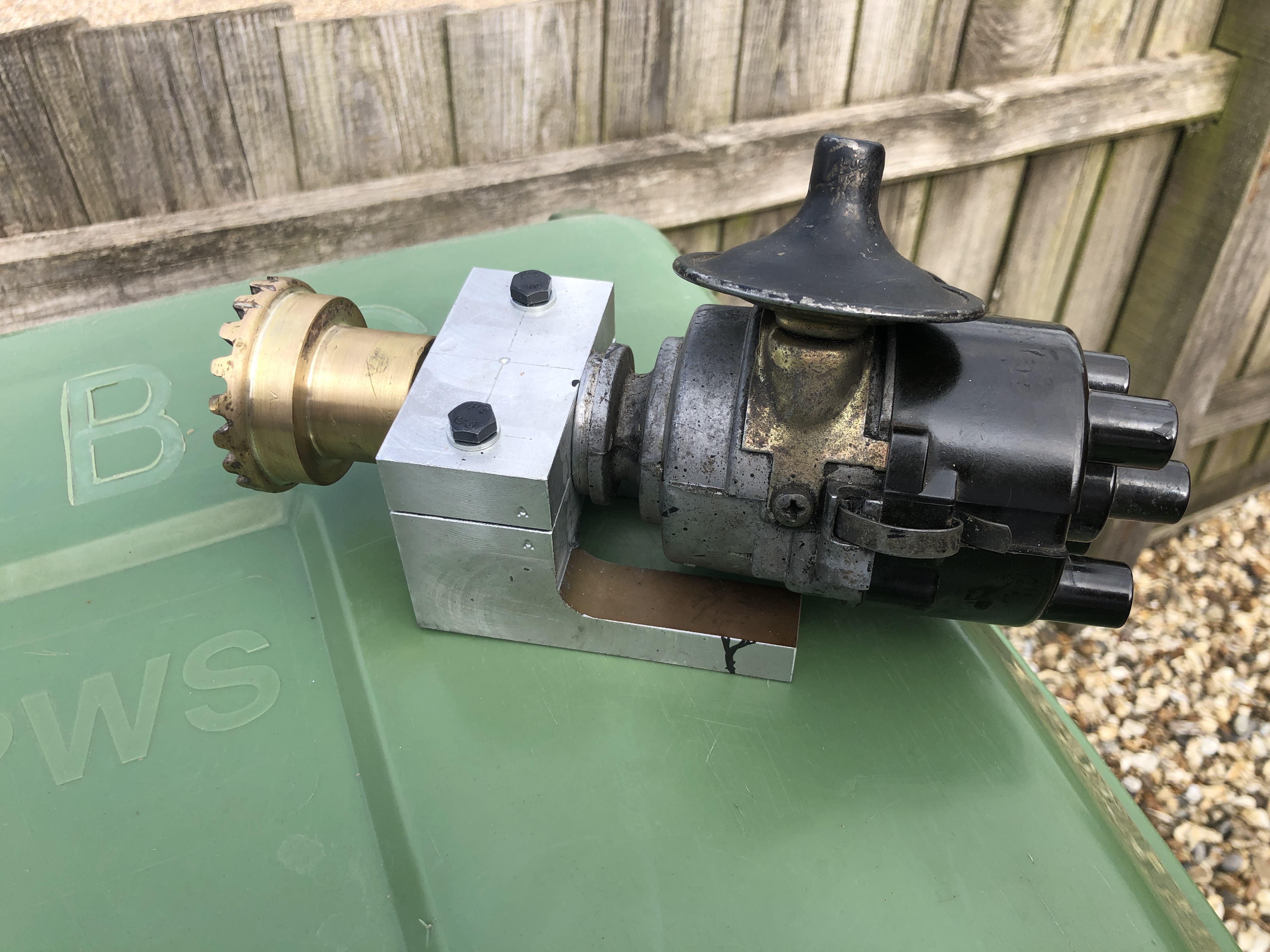

Not trusting the old magneto I made up a mounting for a Lucas distributor & fitted.
It still will not run ( I know it is wasted spark as it runs at the same rotation as the crank, but some cars run this way)

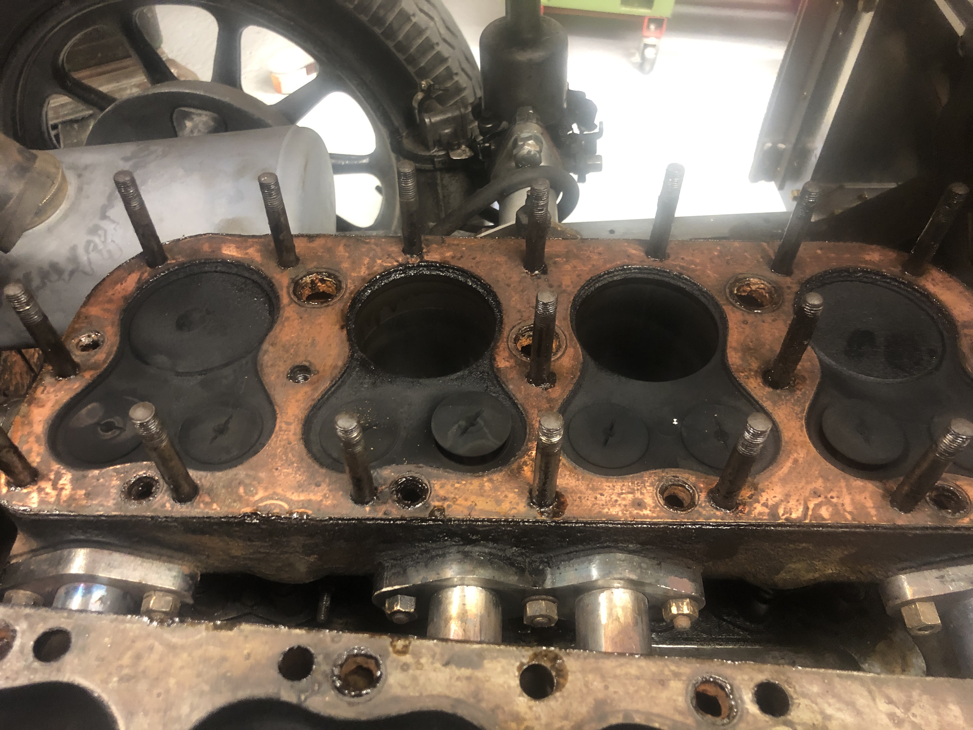

Finally took off the head again can see I have the valve timing a tooth too advanced - see photo - number 1 cylinder at TDC and the exhaust on number 4 has already started to open.
The biggest discovery is that someone has fitted the flywheel Clutch cover 60 deg out from the main flywheel and I can only see the clutch cover markings through the bell housing window. This means I have been setting the ignition timing 60 degrees out I think?
