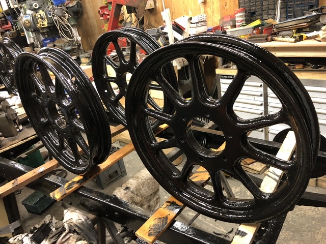

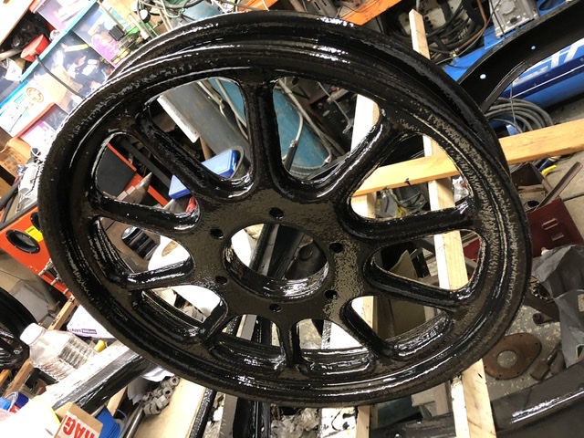

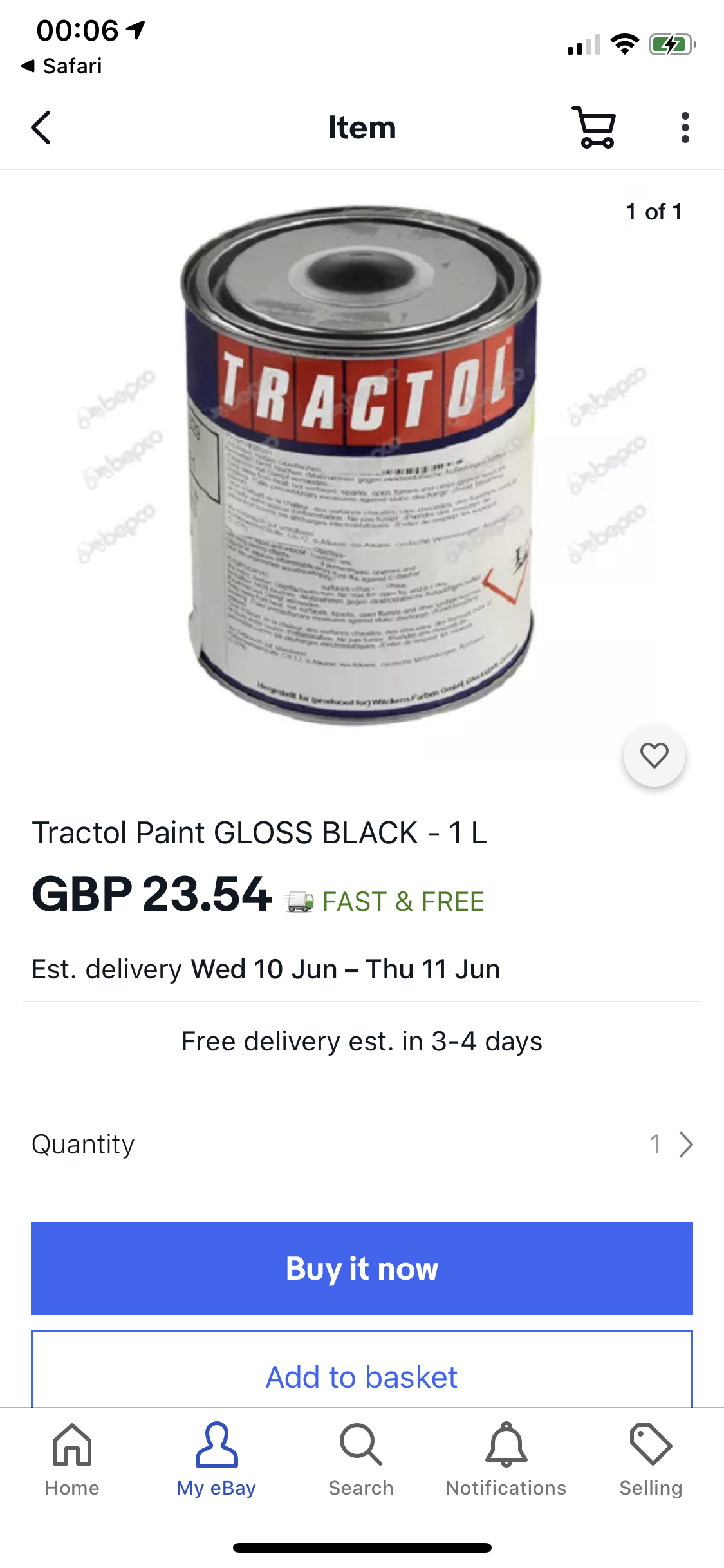

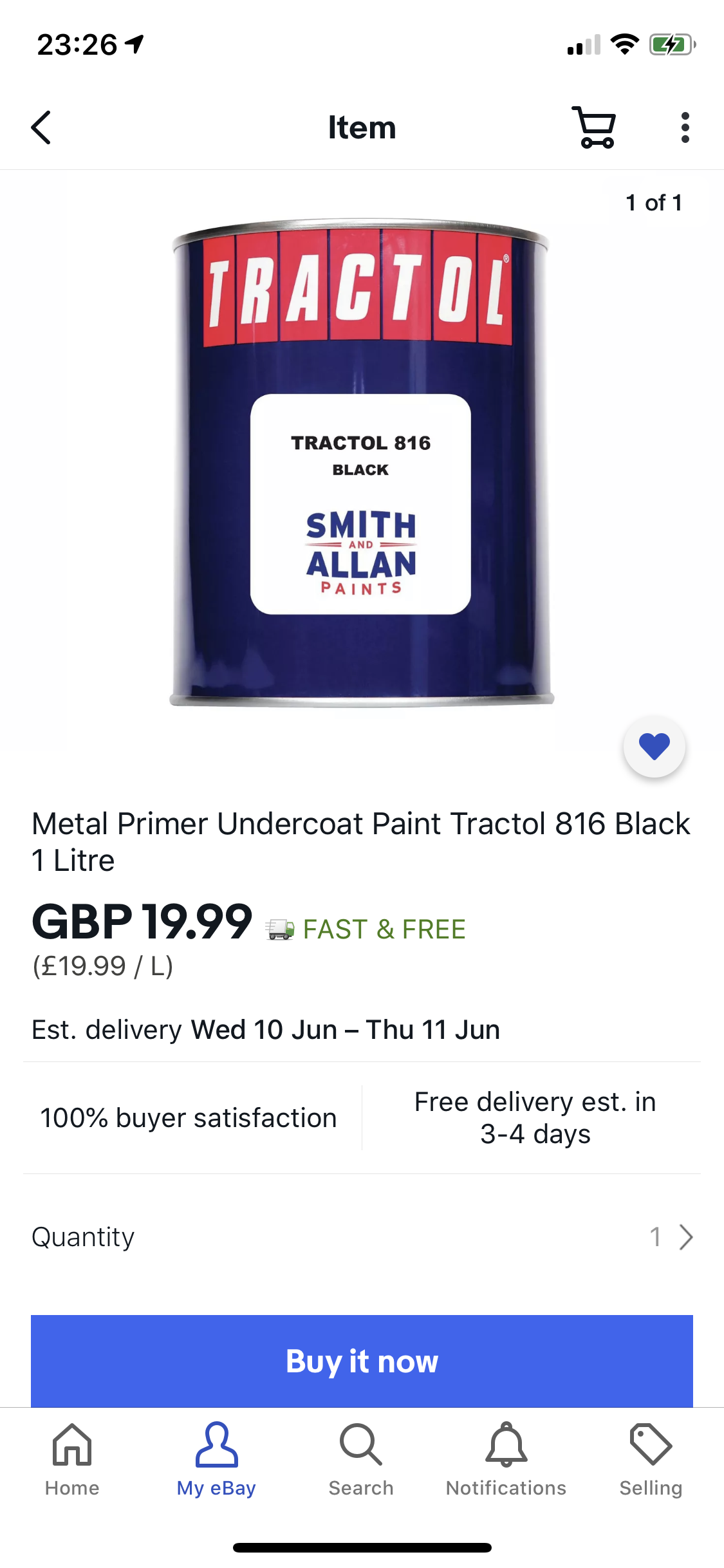

I had mine shot blasted & power coated in zinc phosphate primer then gave them a coat of Tractol 916 black primer then 2 coats of Tractol Black Gloss which I warmed up with a blow lamp until it was steaming hot. It’s too thick when cold.
