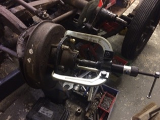

I have over the Christmas break managed to remove all four brake drums using a hydraulic bearing extractor.
I placed 3 wheel nut rings over the studs with a nut on each wheel stud and placed the three puller legs over them - both rears came free with a few light blows from a small copper hammer on the drum rims.
The fronts were a lot easier to get off using the same method.
Now my next challenge is I need to strip the kingpins so I have posted a request in a new thread for this.
I have photos of the hub removal if anyone wants them - I tried posting to here but they are too large for the forum.

- Hydraulic Extractor set up

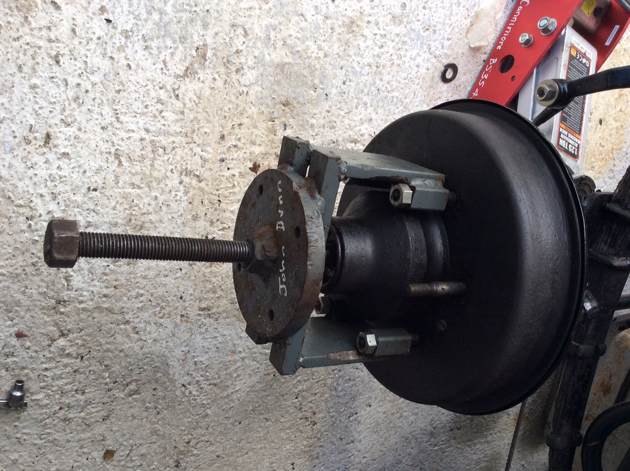

Here are a couple of photos of John Dunn's hub puller, which he has kindly lent to me.
Easily produced if you have welding gear!
